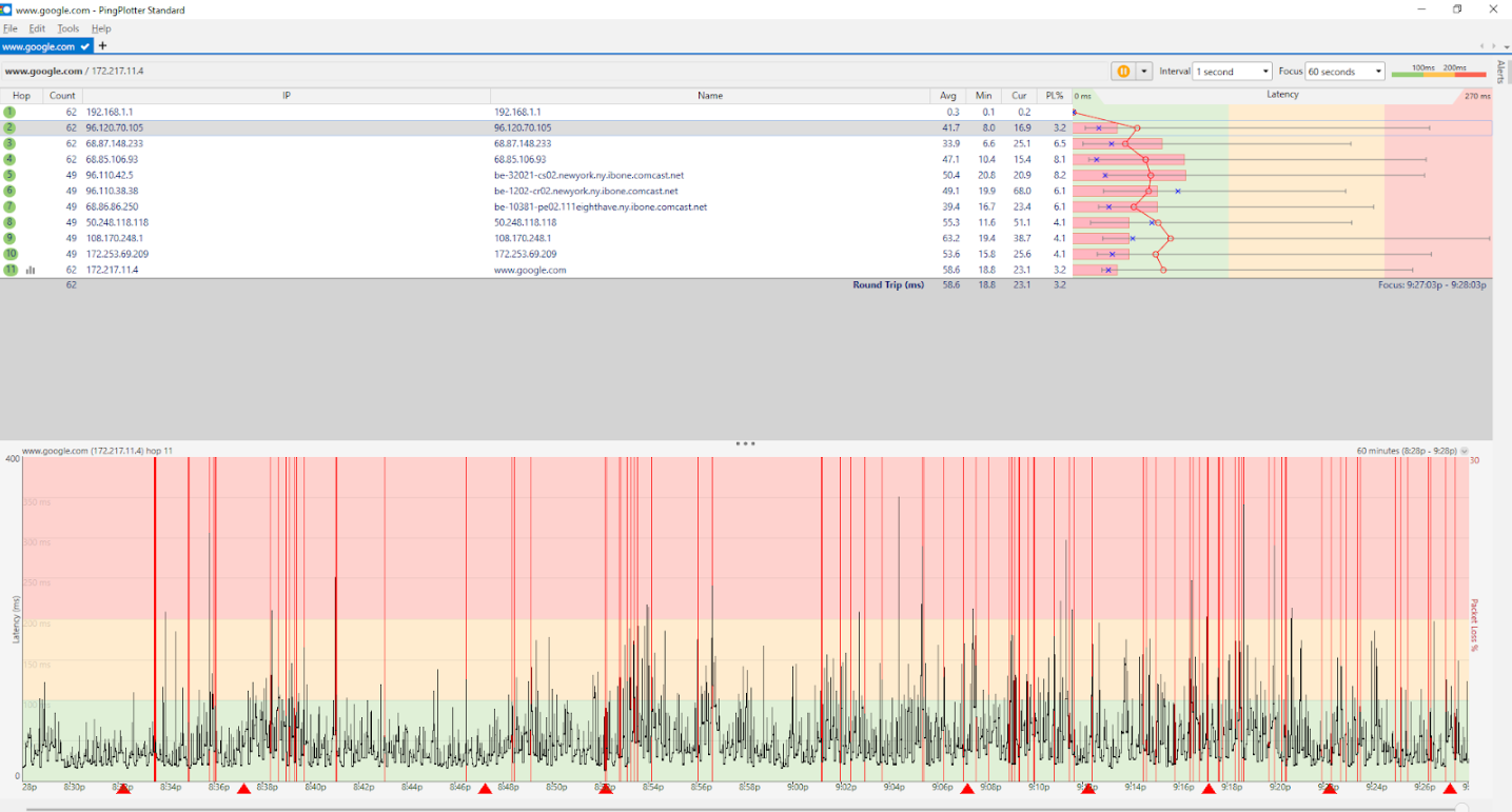

Like many others here, I've been having issues starting with the second hop of trace route. The result is variant latency ranging from 8ms to 400+ms. Sometimes the packets are just lost. It's somewhat tolerable from 02:00 to 10:00, but absolutely awful around 20:00 (even if I have nothing else transceiving during these times), and generally bad anytime else.
I have the typical setup of PC<-ethernet->ROUTER<-ethernet->MODEM<-coax->WALL.
I'm a bit confused about what PingPlotter shows for my second hop (96.120.70.105). When I who.is that, it shows it's owned by my ISP. It would make most sense for that to be my modem, however, it doesn't match my IP address. When I who.is my IP address, it shows it's owned by my ISP, and further, it reports the IP in the right city whereas the 96.120.70.105 IP location is unknown. When I trace my IP, the ping is sub-millisecond and has very little variance. Same goes for 127.0.0.1 and 192.168.1.1. So I'm guessing my modem isn't even listed on PingPlotter for some reason. Just to triple check, I swapped out my modem (and all ethernet and coax cables) with a new one to no avail.
After about a dozen conversations with my ISP, they said they'd have their engineering department look at it, but I'm not holding my breath. Technicians have come and shot the line up to my modem and back out to... not sure where, and observed good dB power levels. I'm not an RF engineer, but I don't think that would necessarily expose latency variation.
It would be great to hear from someone who knows more than me that this is/isn't on my ISP. I don't have 48 hours of collected data to upload here, but the attached image is an hour of capture at the worst time of the day.

The not seeing any IP address for your modem is how it should be as it won't have an IP address unless it's a combination modem/router. A modem is just a two-way converter from the signal that your ISP sends to a signal that your router can understand and vice-versa.
To me, from your screenshot, this looks like a classic case of packet loss that starts with your ISP at the second hop and goes all the way through to the destination. If their engineers actually look at this they should see right away that there is an issue.
If techs have been out and checked your line than and it's good then it's definitely your ISP's problem and it's their responsibility to investigate and fix it. Here is an article about building a compelling case for your ISP. You just have to be the squeaky wheel and not take no for an answer. Be kind, be patient and keep asking to talk with a manager or someone who can address your issue until you get to someone who knows what you're talking about. It will likely be someone in a higher tier of support that you can email your PingPlotter results to who can interpret them.
